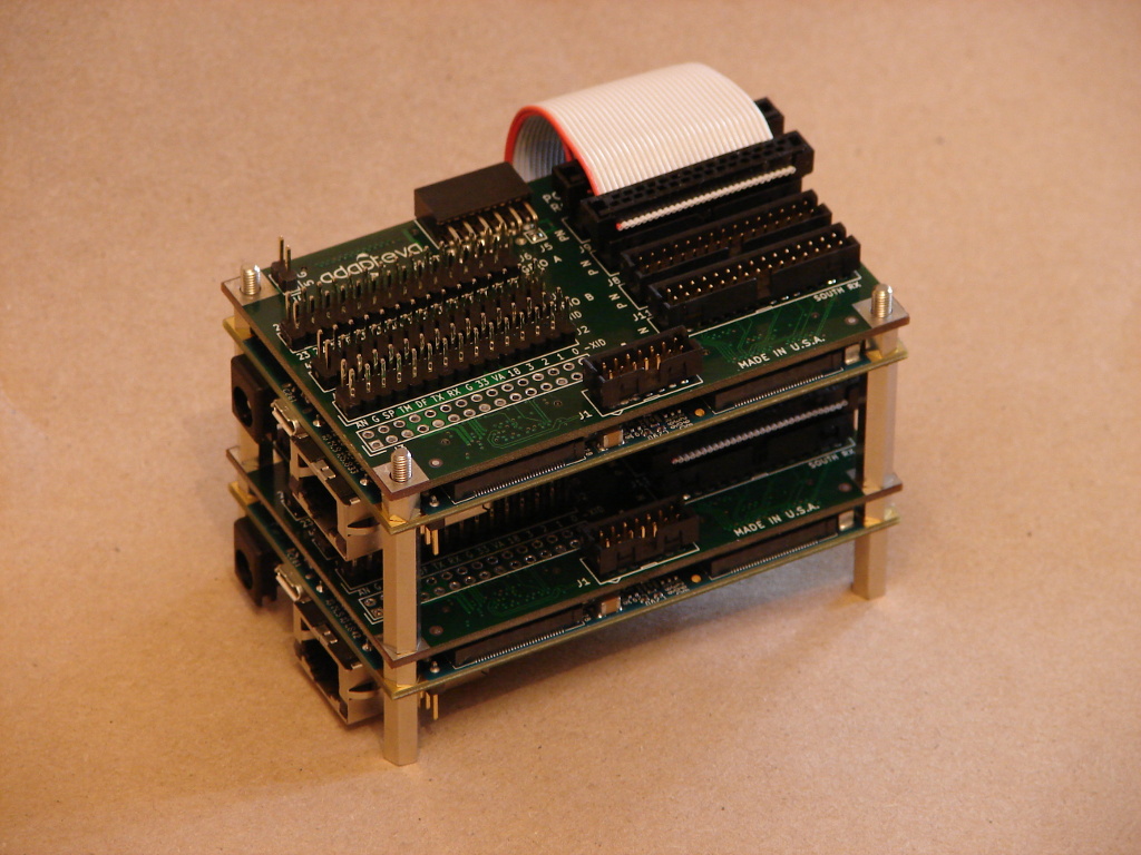

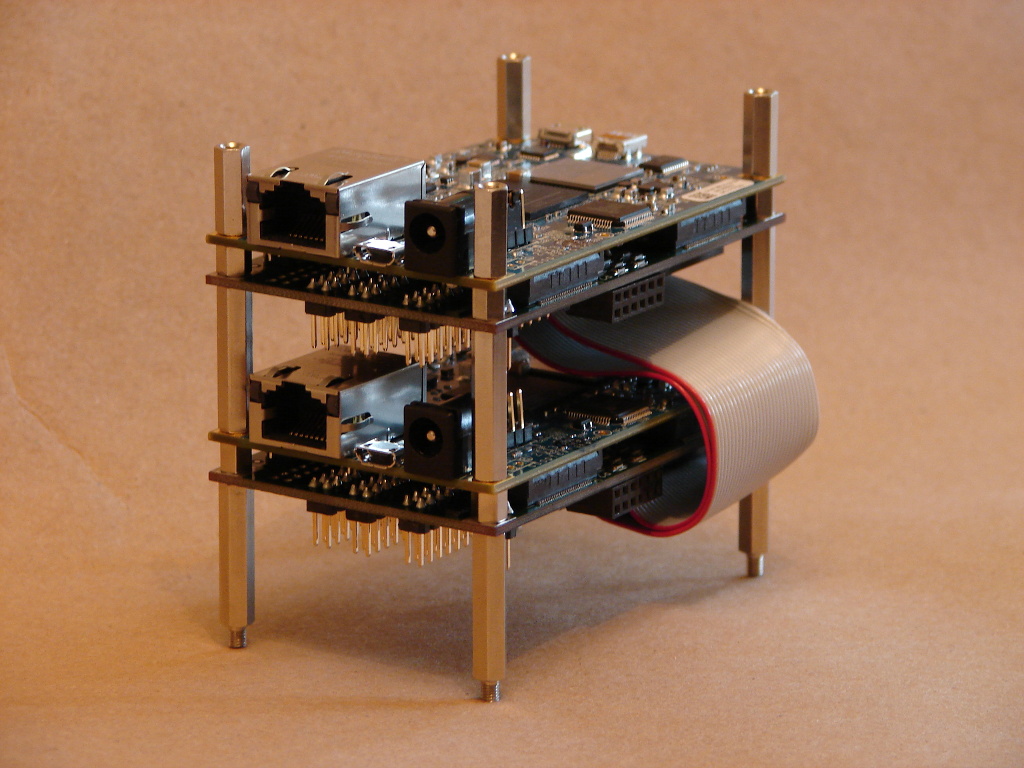

Postby FHuettig » Tue Jan 13, 2015 5:57 pm
Same thing from the Porcupine side.
Parallella + Porcupine w/eLink cables.
