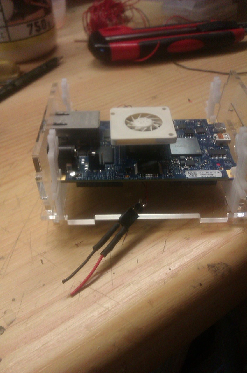

Postby mgt6910 » Wed Apr 09, 2014 11:59 am
I've been sticking soldering irons where others fear to tread for some time !!
I've soldered directly to the 5V mounting hole plus a Grounded mounting hole.
If I did it again, I would not bother with a plug/socket pair on the cable, I don't intend to take it off !
I have glued a mini-fanto the top of the supplied cooler. Picture attached.

Postby pgater » Wed Apr 09, 2014 9:46 pm
Hats off to your soldering skills! :D Much better than mine!
I will try the USB method first as the focus will be to get up and running, and then later maybe solder something in place.
I think that a connection for a fan is already on the mark 2 board wish list, which will be a good idea.

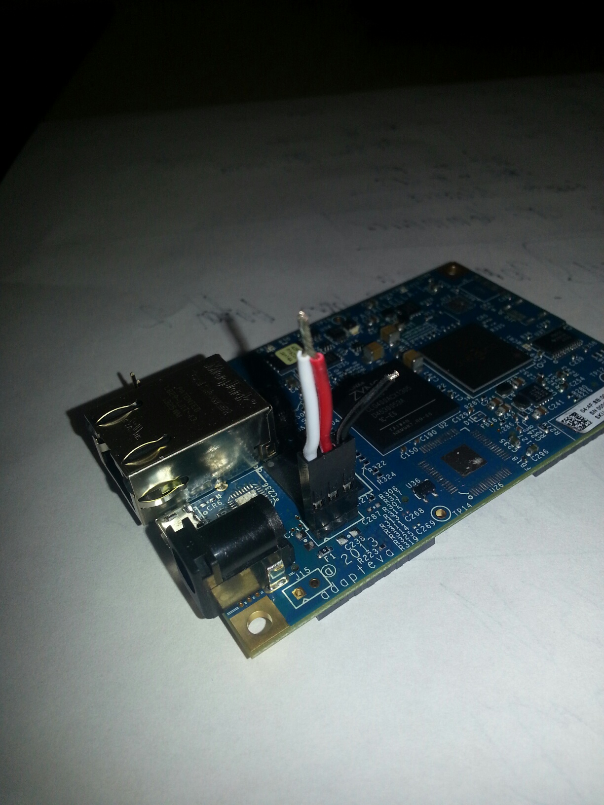

Re: Where can I draw 5V for a fan ?
Postby gceline » Tue May 20, 2014 12:07 pm
Behind the power connector is a three pin jumper - the jumper between pins 1 & 2 is carrying power.
So if you find a two pin cable and cut and short the two cables, then you have a 5VDC lead you can connect and use that to get 5VDC without soldering on the board. I do recommend soldering the connection to ensure good conductivity as this is the main power input to the board.
The three pin jumper next to the Ethernet is serial, but Pin 3 (outside most pin) is GND
Graham
