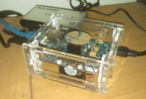

Postby nickoppen » Mon May 19, 2014 11:31 am
Here's my fully tricked out Parallella with 30x30x6mm fan and attached 7-port usb hub. (Sorry about the poor photo.)
The fan keeps the board between 50 and 60 degrees under idle loads. I'd like to crank it up to full load but I'm finding my lack of Linux knowledge a severe impediment.
Appalling phone camera picture

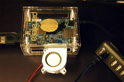

Postby Len » Sat May 24, 2014 1:49 pm
Here is mine. I found a 5 volt blower on ebay, cut a USB cable and spliced it (red to red and black to black).
Had to enlarge the case side vent a bit.

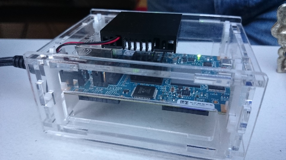

Postby adexmont » Sun Jun 01, 2014 10:12 am
another photo of the board (not yet able to boot it, need some more hardware :P)
i mount my board near my pc so i can retrieve the needed power from my desktop psu (board, fan and maybe even the peripherals)
added a copper plate over the epiphany to keep i colder (pice of copper from other hardware disassembled with thermal ribber found inside old cd reader , this may work) and assure that copper do not touch any component.
https://lh6.googleusercontent.com/-LJ5y ... 040077.JPG
i posted a link because the dimension limit on the forum.

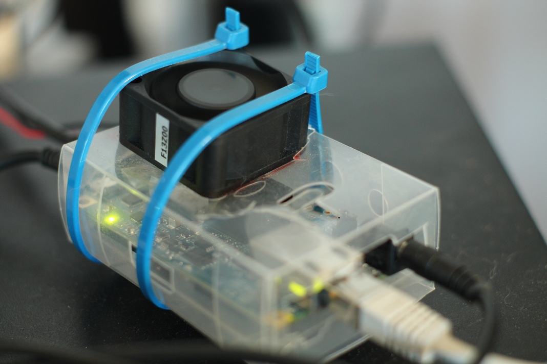

Postby Bikeman » Wed Jun 25, 2014 6:30 pm
Hi!
So this is my Kickstarter backer reward Parallella (16 core), inside a folded-plastic case originally intended for Raspis, with a 5V fan attached in a slightly improvised way :oops: . But it works.
Cheers

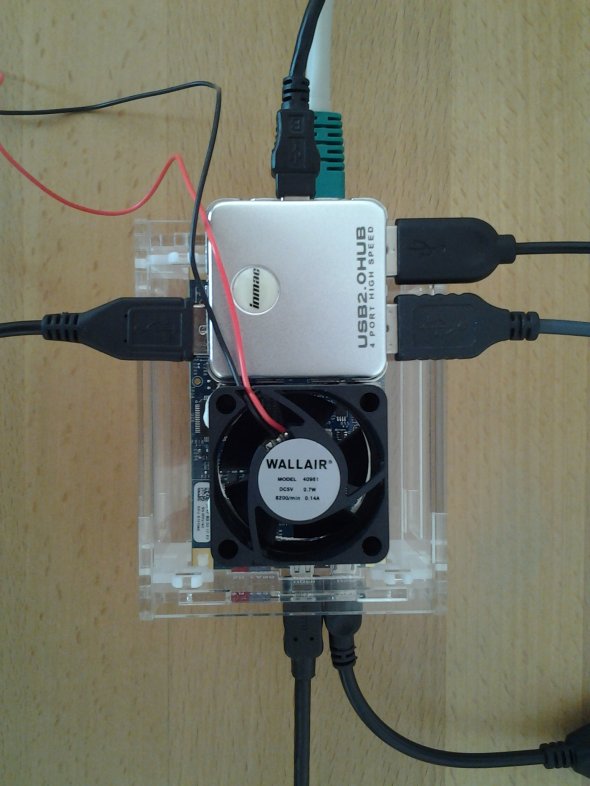

Postby TheKr1S » Wed Jun 25, 2014 8:18 pm
Got it!
Created a hole in the top plane for the fan (pitty for the logo but ..). The fan is sucking the air out of the case. Used a 12v 0.11A fan. Connected to the 5V power supply, it's rotating not that fast and therefore quite silent. Airflow is more that enough to keep it cool.
Now creating sd card. Excited to start playing with it.

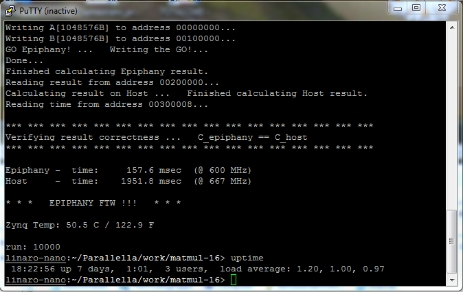

Postby miro » Tue Jul 01, 2014 5:00 am
I made my Burn-In test with my 3cm Fan in case, runing it now for over 7 days. Yesterday I started 10.000 loops over matmul-16 example, and everything stays very cool 8-)
