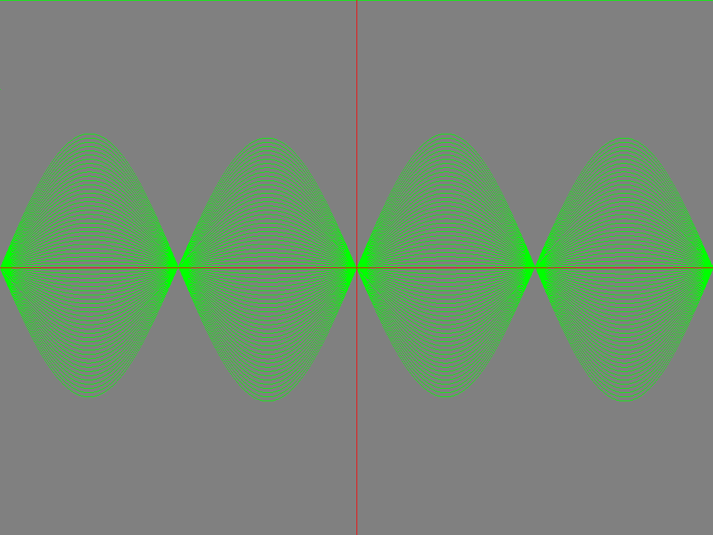

yes, back to my CLUSTER of 4 PARALLELLA project at my new Academic year of Courses.
Now my CLUSTER has 64 cores.
The test picture is the following: the points of each sin(alpha) line has been drawn by a single core for a total of 64 flows.

64 graph, one per core
