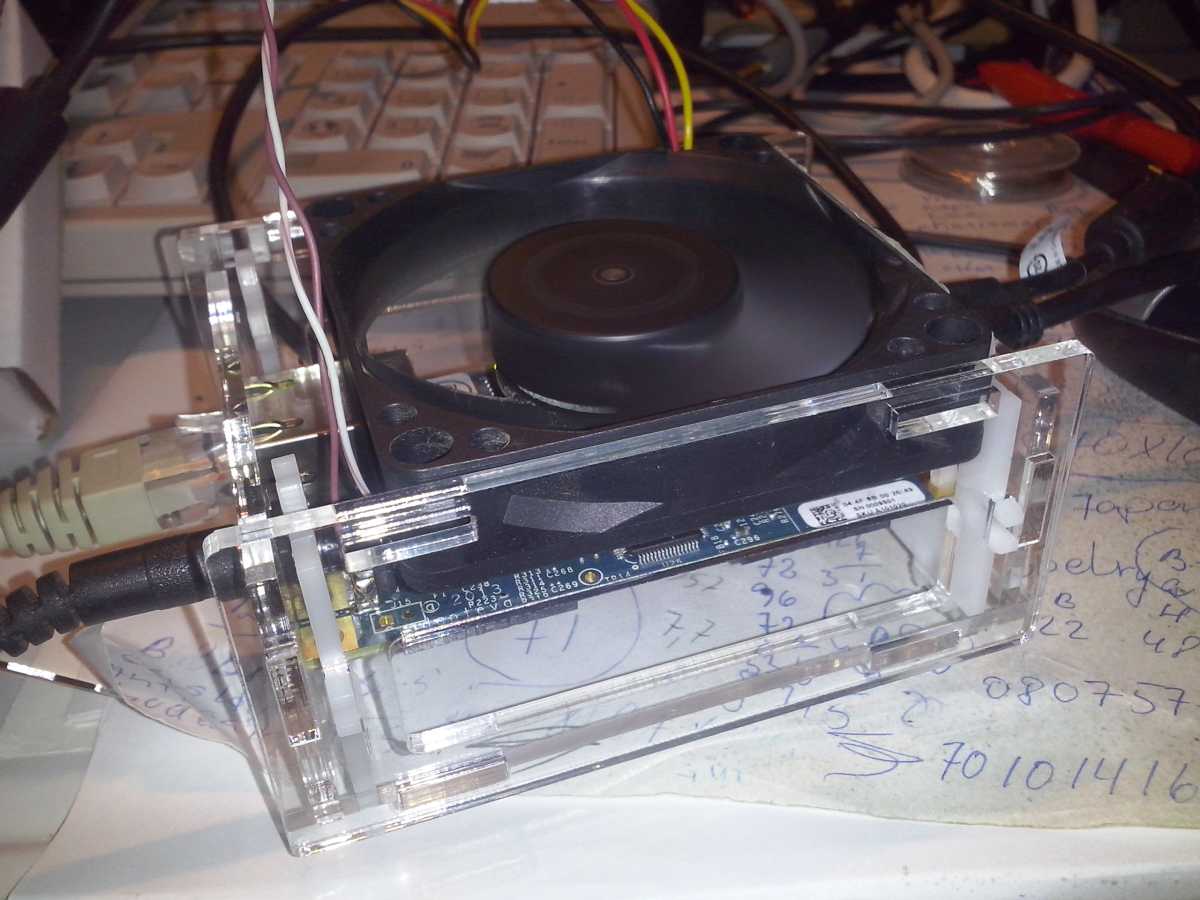

Then every thing on a 32Gbyte sdcard. Find a hdmi cable and a powersupply. Power on and a finger on the heatsink, and nothing happen. Well after some thought, it was maybe an idea to follow the text, and change the name of
parallella_e16_hdmi_gpiose_7010.bit.bin, to parallella.bit.bin.

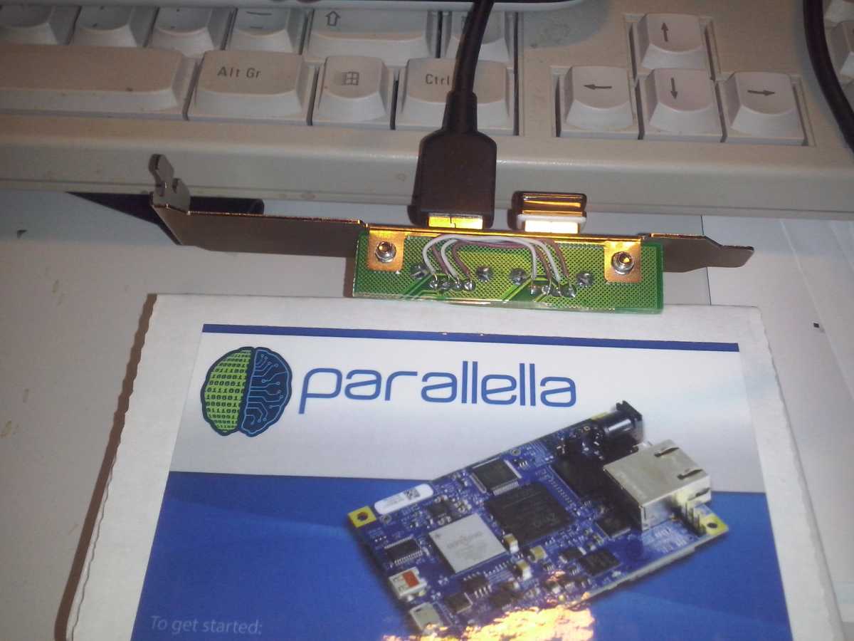

Then power on again, and this time I got a screen, where I have to lock in. Power off, find a usb cable and a keyboard and a blower.
Power on again and here I am writting on a Parallella.
Once again thank you very much.
