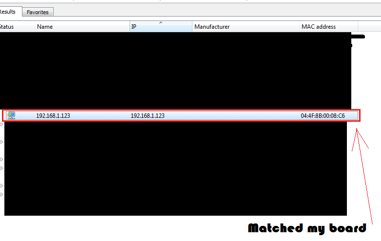

Try using the Advanced IP scanner and see if the Parallella appears on the network:
Then you'll at least know if it's booting O.K
Claggy

Thanks. Downloaded, installed & scanned. My board was detected on my network. Is there a problem with the kernel? Any specific requirement on HDMI cable?

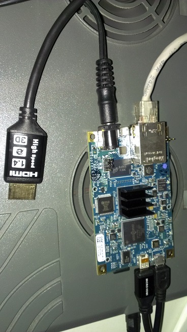

I'm using this HDMI cable.
Ps: placing the board on a notebook fan as it gets extremely HOT after a few minutes of running.

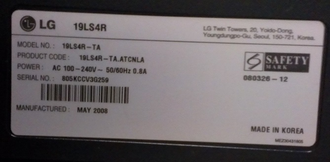

What monitor are you using?

I'm using LG, Model: 19LS4R-TA.
My Ras-pi Model B worked but not my Gen-1 board... :?

MacTuxLin,
The blinking of the ethernet LED of your Parallella is a bit strange.
