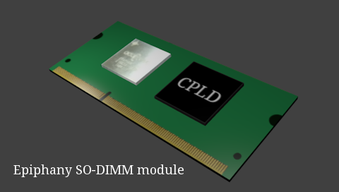

Postby shodruk » Tue Apr 08, 2014 4:53 pm
Epiphany SO-DIMM module inspired by
Re: Ideas for daughter cards?
Postby aolofsson » Tue Apr 08, 2014 5:39 pm
Nice :D
Using the SODIMM concept is well known and there are quite a few boards out there already with this form factor. Here's one from Switzerland that uses the Zynq:
http://www.enclustra.com/en/products/fp ... /mars-ax3/
Not sure if this is our highest priority, but the Parallella is open source so if there is a market for this type of SODIMM I am sure somebody will build one. :D
